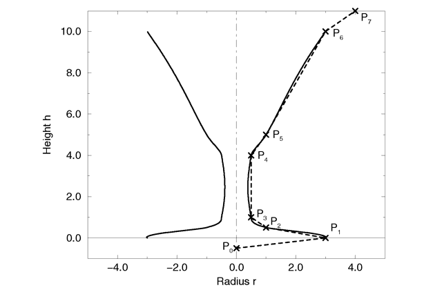

We first start by thinking about the shape of the final object. It is quite difficult to come up with a set of
points that describe a given curve without the help of a modeling program supporting POV-Ray's surface of revolution
object. If such a program is available we should take advantage of it.
We will use the point configuration shown in the figure above. There are eight points describing the curve that
will be rotated about the y-axis to get our cup. The curve was calculated using the method described in the reference
section (see "Surface of Revolution").

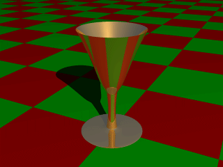

The scene contains our cup object resting on a checkered plane. Tracing this scene results in the image below.
The surface of revolution is described by starting with the number of points followed by the points. Points from
second to last but one are listed with ascending heights. Each of them determines the radius of the curve for a given
height. E. g. the first valid point (second listed) tells POV-Ray that at height 0.0 the radius is 3. We should take
care that each point has a larger height than its predecessor. If this is not the case the program will abort with an
error message. First and last point from the list are used to determine slope at beginning and end of curve and can be
defined for any height.
