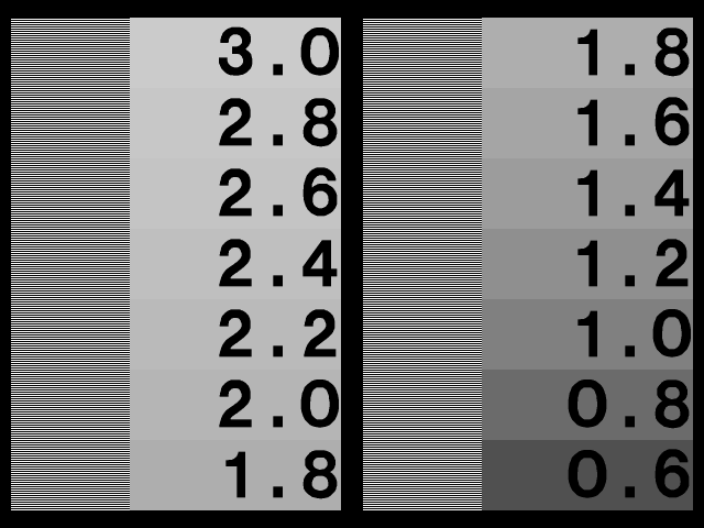

The Display_Gamma
setting overcomes the problem of images
(whether ray-traced or not) having different brightness when being displayed
on different monitors, different video cards, and under different operating
systems. The Display_Gamma=
n.n setting is not
available as a command-line switch.
Note: The Display_Gamma
is a setting based on your
computer's display hardware, and should be set correctly once and not
changed.
While the Display_Gamma
can be different for each system,
there are a few general rules that can be used for setting
Display_Gamma
if you do not know it exactly. If the
Display_Gamma
keyword does not appear in the INI file, POV-Ray assumes
that the display gamma is approximately 2.2 (to precise, that it matches the sRGB standard). This is because most PC monitors have a gamma
value in the range 1.6 to 2.6 (newer models seem to have a lower gamma
value). Mac has the ability to do gamma correction inside the system software
(based on a user setting in the gamma control panel). If the gamma control
panel is turned off, or is not available, the default Macintosh system gamma
is 1.8. Many newer PC graphics cards can do hardware gamma correction and
should use the current Display_Gamma setting, usually sRGB
(being approximately equivalent to a gamma of 2.2).
The following gamma test image can be used to help you set your Display_Gamma
accurately.
Before viewing the gamma image darken the room and set the monitor brightness and contrast to maximum. While viewing a black screen, lower the brightness gradually until the background is no longer noticeable (ie when it just fades from view). This may be difficult on monitors that use overscanning, unless you change the viewable area settings.
Display gamma test image. |
Now, lower the contrast until the alternating white and black bars on the left edge of each column are equal in width. This is trying to get a 50% gray by using half white and half black. If this is not possible, choose a contrast setting which is about in the middle. While viewing the image from a distance, or with squinted eyes, one of the numbered swatches will best match the gray value approximated by the white and black bars. The number in this swatch is your display's actual gamma value.
Normal display gamma values are in the range 2.0 to 2.6. If your monitor is usually used in a dim environment, we often use a gamma value that is 15% - 25% lower than the actual display gamma to give the images more contrast. Some systems, such as Macs and SGIs, already do gamma correction, so they may have display gammas of 1.0 or 1.8.
See the Gamma Handling tutorial for additional information about setting up your display and why gamma handling is so important.

File_Gamma= x.x |
Sets output file gamma to n.n |
File_Gamma=sRGB |
Selects the sRGB transfer function instead of a power-law output file gamma |
File_Gamma
setting specifies the target display gamma for which to pre-correct (typically a value in the range from 1.6 to around 2.5, with 2.2 being the most commonly used), and will have an influence on the brightness and saturation of the image when displayed.
Some other file formats do have a clearly specified gamma handling policy, but allow for gamma encoding with an arbitrary gamma value (currently only PNG). For such formats, File_Gamma
specifies the decoding gamma or, in other words, the inverse of the encoding gamma to use, and will have no effect on the brightness and saturation of the image when displayed with contemporary software; the setting will however affect the likelihood of banding artifacts.
The parameter has no effect on file formats mandating linear storage of color values (currently OpenEXR and Radiance HDR).
Alternatively to a numeric value, sRGB
can be specified, instructing POV-Ray to employ the sRGB transfer function, which is similar but not quite identical to a power-law gamma curve with a gamma of 2.2. sRGB
is also the default on all platforms currently supported.
See section Gamma Handling for more information on gamma.

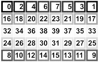

POV-Ray provides a mechanism to specify the order of render block via either an INI-style option Render_Pattern
=n or on the command-line +RP
n, where n is an integer between 0 and 5. This represents the various orders for the distribution of the blocks to the render threads. The default value is 0.
If you specify a value that is greater than the maximum number of patterns, it will revert to the default. Using a different Render_Pattern
has only an effect on the preview of the rendered image, as the first blocks might be placed differently, but does not change the final image once the render has been completed.
Pattern 0: is the classical order. The first block is in the top left corner, and it progress from left to right, and then it continues on the next row of blocks. Just like reading text. |
Pattern 0 |
Pattern 1: is the same as pattern 0, but the rows and columns are swapped. It starts at the top left corner and it progress from top to bottom. |
Pattern 1 |
Pattern 2: The top row is processed first, starting at each corner and meeting at the center of the row, then the bottom row is processed the same way. The last block is at the very center of the image. |
Pattern 2 |
Pattern 3: Is the opposite order of pattern 2, the first block is at the center of the image, the expansion being firstly horizontal. |
Pattern 3 |
Pattern 4: Is the same as pattern 2, except that the rows and columns have been swapped. |
Pattern 4 |
Pattern 5: Is the same as pattern 3, but the rows and columns are swapped, however the expansion from the center of the image is firstly vertical. |
Pattern 5 |
Whatever the chosen pattern (with +RP
), the number of the next processed block can be incremented by more than 1, to jump over blocks, via either an INI-style option Render_Block_Step

Assuming an image made of 40 blocks, with +RS9
, the order of block numbers would be:
0, 9, 18, 27, 36, 5, 14, 23, 32, 1, 10, 19, 28, 37, 6, 15, 24, 33, 2, 11, 20, 29, 38, 7, 16, 25, 34, 3, 12, 21, 30, 39, 8, 17, 26, 35, 4, 13, 22, 31.
The same 40 blocks with +RS8
would in fact use +RS7
instead. As would a +RS2
in fact be reduced to +RS1
the default.

As the human eye is more sensitive to absolute brightness differences at a low overall brigtness than at higher ones, super-sampling based on linear light intensity differences would yield either poor anti-aliasing in darker regions, or unnecessary super-sampling in brighter regions of the image. To avoid this, POV-Ray compares ''gamma-adjusted'' values instead. (Note that this only affects the comparison operation; the averaging of the super-samples is done in whatever working color space is specified in the scene file via the assumed_gamma
keyword.) The Antialias_Gamma=
n.n command line option or +AG
n.n sets the gamma to apply before comparison, defaulting to 2.5. Note that the value is actually the inverse of the gamma applied, in order to use the same value range as the display and file gamma settings. Neutral behavior can be achieved using Antialias_Gamma=1.0
