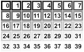

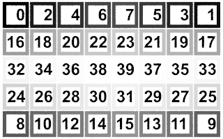

3.2.3.2 Setting your Display Gamma

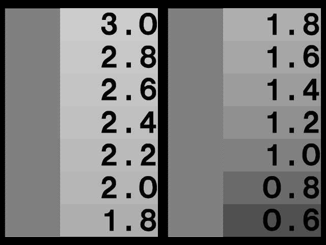

The following gamma test image can be used to help you set your Display_Gamma accurately.
Before viewing the gamma image darken the room and set the monitor brightness and contrast to maximum. While viewing a black screen, lower the brightness gradually until the background is no longer noticeable (ie when it just fades from view). This may be difficult on monitors that use overscanning, unless you change the viewable area settings.
Display gamma test image.
Now, lower the contrast until the alternating white and black bars on the left edge of each column are equal in width. This is trying to get a 50% gray by using half white and half black. If this is not possible, choose a contrast setting which is about in the middle. While viewing the image from a distance, or with squinted eyes, one of the numbered swatches will best match the gray value approximated by the white and black bars. The number in this swatch is your display's actual gamma value.
Normal display gamma values are in the range 2.0 to 2.6. If your monitor is usually used in a dim environment, we often use a gamma value that is 15% - 25% lower than the actual display gamma to give the images more contrast. Some systems, such as Macs and SGIs, already do gamma correction, so they may have display gammas of 1.0 or 1.8.
See the Gamma Handling tutorial for additional information about setting up your display and why gamma handling is so important.

3.2.4.5 Output File Gamma
File_Gamma=x.x Sets output file gamma to n.n
File_Gamma=sRGB Selects the sRGB transfer function instead of a power-law output file gamma
Many file formats traditionally have no clearly specified gamma handling policy, and require images to be gamma pre-corrected for whatever target system they are to be displayed on. For such file formats (currently all except PNG, OpenEXR and Radiance HDR), the File_Gamma setting specifies the target display gamma for which to pre-correct (typically a value in the range from 1.6 to around 2.5, with 2.2 being the most commonly used), and will have an influence on the brightness and saturation of the image when displayed. Some other file formats do have a clearly specified gamma handling policy, but allow for gamma encoding with an arbitrary gamma value (currently only PNG). For such formats, File_Gamma specifies the decoding gamma or, in other words, the inverse of the encoding gamma to use, and will have no effect on the brightness and saturation of the image when displayed with contemporary software; the setting will however affect the likelihood of banding artifacts. The parameter has no effect on file formats mandating linear storage of color values (currently OpenEXR and Radiance HDR). Alternatively to a numeric value, sRGB can be specified, instructing POV-Ray to employ the sRGB transfer function, which is similar but not quite identical to a power-law gamma curve with a gamma of 2.2. sRGB is also the default on all platforms currently supported. See section Gamma Handling for more information on gamma.

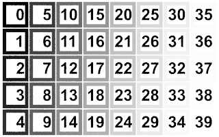

Pattern 0: is the classical order. The first block is in the top left corner, and it progress from left to right, and then it continues on the next row of blocks. Just like reading text.
Pattern 0

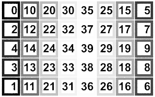

Pattern 2: The top row is processed first, starting at each corner and meeting at the center of the row, then the bottom row is processed the same way. The last block is at the very center of the image.
Pattern 2

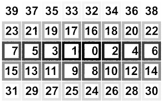

Pattern 3: Is the opposite order of pattern 2, the first block is at the center of the image, the expansion being firstly horizontal.
Pattern 3

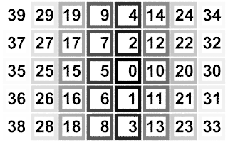

Pattern 4: Is the same as pattern 2, except that the rows and columns have been swapped.
Pattern 4
Pattern 5: Is the same as pattern 3, but the rows and columns are swapped, however the expansion from the center of the image is firstly vertical.
Pattern 5

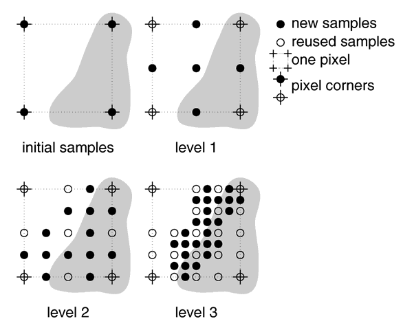

The second, adaptive, recursive super-sampling method starts by tracing four rays at the corners of each pixel. If the resulting colors differ more than the threshold amount additional samples will be taken. This is done recursively, i.e. the pixel is divided into four sub-pixels that are separately traced and tested for further subdivision. The advantage of this method is the reduced number of rays that have to be traced. Samples that are common among adjacent pixels and sub-pixels are stored and reused to avoid re-tracing of rays. The recursive character of this method makes the super-sampling concentrate on those parts of the pixel that are more likely to need super-sampling (see figure below).
Example of how the recursive super-sampling works.
The maximum number of subdivisions is specified by the Antialias_Depth=n option or +Rn switch. This is different from the adaptive, non-recursive method where the total number of super-samples is specified. A maximum number of n subdivisions results in a maximum number of samples per pixel that is given by the following table. Where the first column represents anti-alias depth or +Rn option. The second column is the number of additional samples per super-sampled pixel for the non-recursive method +AM1. Lastly the third column is the maximum number of samples per super-sampled pixel for the recursive method +AM2.
