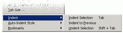

3.5.4.4 Indent
See the Selection Sub-Menu.

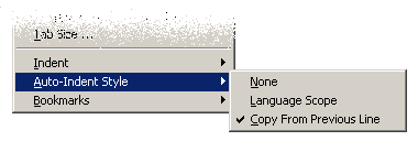

3.5.4.4.1 Auto-Indent Style
3.5.4.4.2 None
No indentation occurs. The next line begins at column 1.
3.5.4.4.3 Language Scope
Language-specific scoping is used to determine the correct indentation level for the next line. This setting causes the editor to parse the buffer contents, looking backward for scope keywords until the start of the current scope is encountered. Once found, the indentation is copied to the next line. If no language is set, the editor acts as if 'Copy From Previous Line' was chosen.
3.5.4.4.4 Copy From Previous Line
Indentation is copied from the previous line.
