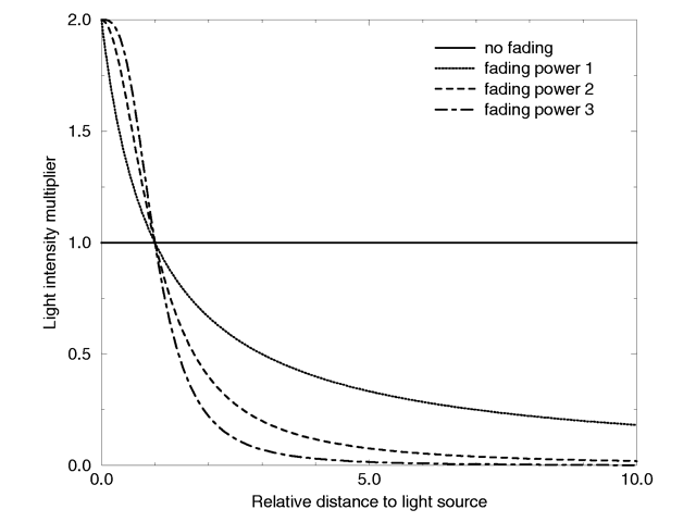

The fade_distance is used to specify the distance at which the full light intensity arrives, i. e. the intensity which was given by the COLOR specification. The actual attenuation is described by the fade_power Fade_Power, which determines the falloff rate. For example linear or quadratic falloff can be used by setting fade_power to 1 or 2 respectively. The complete formula to calculate the factor by which the light is attenuated is
with d being the distance the light has traveled.
Light fading functions for different fading powers.
You should note two important facts: First, for Fade_Distance larger than one the light intensity at distances smaller than Fade_Distance actually increases. This is necessary to get the light source color if the distance traveled equals the Fade_Distance. Second, only light coming directly from light sources is attenuated. Reflected or refracted light is not attenuated by distance.
